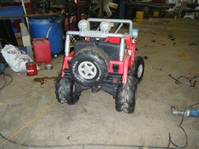

Ok, so I got the bright idea to get my (soon-to-be) 4 year old daughter a PowerWheels for Christmas this year. I'm going through a divorce and broke as a joke, so I knew that I wouldn't be able to afford a new one. I started watching the local craigs-list postings to see what people were getting for their used ones. I found a lady getting rid of a little red Jeep for $40. "Works Great" she said... took it home and found the battery was shot, there was some damage to the windshield, and it needed some minor cosmetic work. Purple is my daughter's favorite color, so I decided to paint it. That's when I stumbled onto this site...
I don't want to say that I'm hooked, but the potential is certainly there. Anyway, I figured I'd share my first project with you all so you can tell me how bad I'm f'n things up. lol!
Here's what I started with:

At last, I think the FairyRock is (mostly) finished!
Here's everything I've done/added/modded:
-headlights
-taillights
-floodlights
-12V high/low (with time delay high speed)
-26ah battery
-key start
-voltmeter
-MP3 w/ amp & stereo speakers
-horn
-110V charge port
Some pics:
all back together
lit up
MP3 and volume knob
key, headlights, floodlights, and horn (the steering wheel center cap is the horn switch)
12V 26ah battery showing a little... I had to trim the seat to get it to fit.
charge port
basement test run (in the dark)
very short high-speed test
I'd put a pic of the wiring up, but it's more than a little embarrassing. It's far from clean. It's safe and everything, but it's just a tangled mess.
